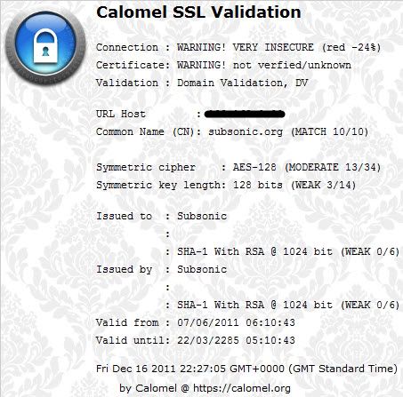

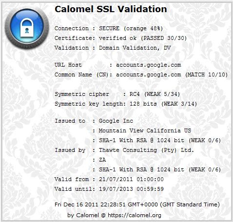

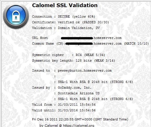

Postby BKKKPewsey » Fri Dec 16, 2011 10:42 pm
FYI Subsonic certificate report and comparison with WHS and google
Subsonic
WHS
Google
Re: Need some help with security issues
Postby mikes » Fri Dec 16, 2011 10:58 pm
sindre_mehus wrote:I'm a bit surprised to hear that the certificate bundled with Subsonic uses a cipher length of <112 bits, I thought it was 1024 bits.
1024 is the key length, from the certificate, which is used for authentication. Encryption is separate. It looks like jetty supports weak encryption as the default configuration, and the ciphers are old (SSL_DHE_RSA_WITH_DES_CBC_SHA and SSL_DHE_DSS_WITH_DES_CBC_SHA are 56 bit). You may be able to pick others available in the current version of the JVM, and use 1 or more of those (like TLS_DHE_RSA_WITH_AES_256_CBC_SHA) in place of the defaults. Not that up on Java, or I'd try to help more. Also see here.
