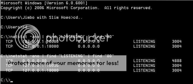

>netstat -ano | find "LISTENING" | find "80"
  TCP    0.0.0.0:80            0.0.0.0:0              LISTENING       1412
This means that process id 1412 is listening on TCP port 80 on all interfaces ( ip 0.0.0.0 just means "all" if you should have multiple interfaces )
Now you either have subsonic running directly on port 80 or you should see both port 80 and 8080 ( the default tomcat port ) in the list above. Use the task manager to find out what is listening to port 80 by tracking down the pid 1412.
To set up Task Manager to show the PID column open Task Manager by using CTRL+SHIFT+ESC. Go to the Processes tab, click View and then Select Columns. In the Select Columns windows click to select PID and then click Ok. You can sort the PID column to display the PIDs in descending or ascending order.

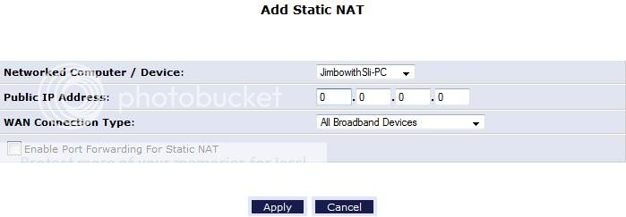

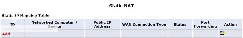

I've set up a photobucket account to help me out with all of this! :shock:
When I click on 'add' I'm brought to this screen. The first option is to select a device (my PC) or I can specify an IP address.
As you can see it then asks for a 'Public' IP address. After reading your note about the Static NAT being used for an internal IP address I changed it from the IP you see in this picture to my router assigned IP address After doing so I no longer had access to the internet. Is it possible that this is actually for a static External or 'Public' IP address and not internal?
This just makes me wonder if I should even screw with it because I have the dyndns.org domain and IP updater running; seems like over kill.

I ran the code you mentioned in command prompt with the two following results:
The first result was when I had the Subsonic Tray Icon 'stopped'.
The second result was with it running on port 80.
I checked the PID's in the Services section of the Task Manager and found that subsonic was PID 4888 (matching the port from the second report). I assume that this means that Subsonic is listening on port 80. I also assume that no other program is listening on port 80 or there would either be a conflict or multiple PID's listed here that aren't 127.0.0.1: etc... (Correct me if I'm wrong)

Postby jigsaw » Wed Jul 29, 2009 10:55 pm
Hi again
It looks like you've got everything but the port forwarding setup. That would cause any online tool to present the port 80 as closed or unreachable. At this point I can see that the router you are using is quite different from any I have ever used. So I suggest you basically google "port forwarding" and the name of the router and see if you find out what you are doing wrong.
Hope that helps
