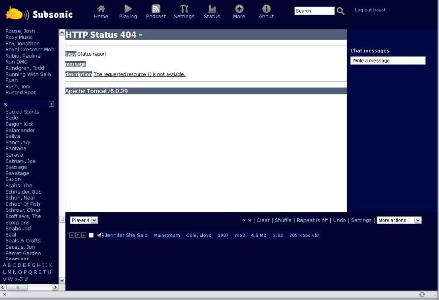

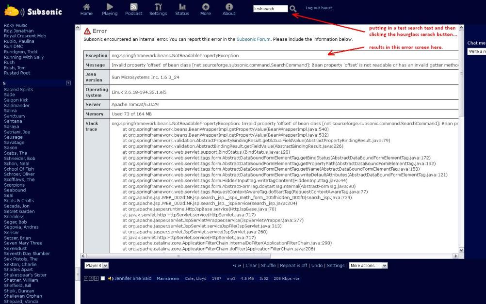

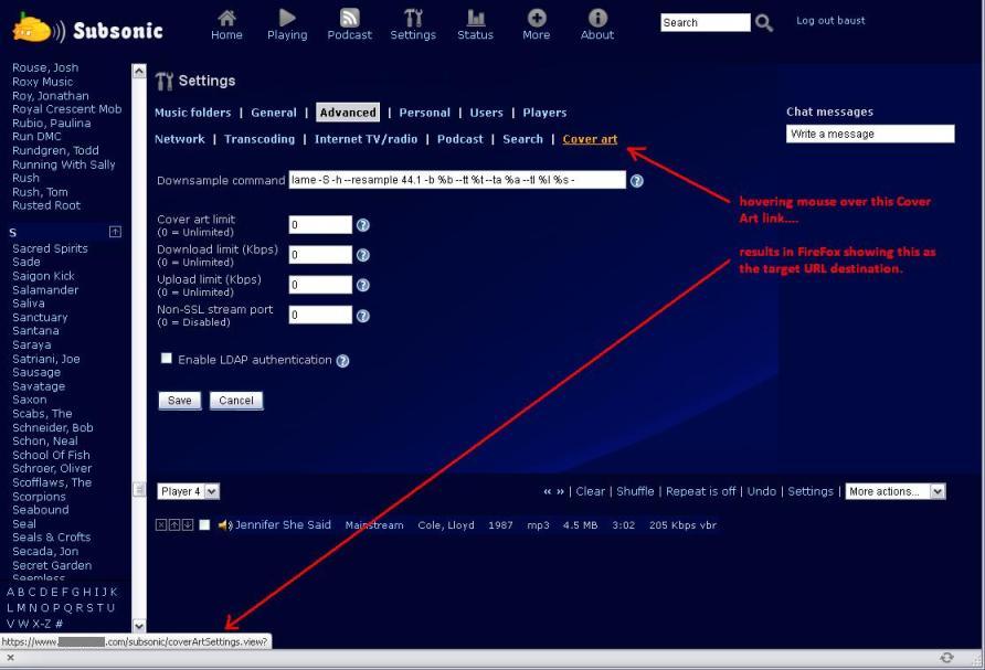

Postby supra92 » Thu Apr 07, 2011 7:15 pm
I absolutely love SS, donating member, user since 2003, etc. etc. But the most recent 4.4 version seems to really have some bugs when it comes specifically to the Linux/Tomcat .WAR version.
I'm getting fullblown java bean errors on Search, and the Cover Art link under Settings results in a 404 resource not found error. I've talked with a few other people who are using the standalone jetty version and they are not having these same issues.
I'll be back-rev'ing either to my previous 4.1 version (if time is lacking), or I'll try reverting to the previous 4.3 and see what happens. I've confirmed several times that 4.1 runs perfectly.

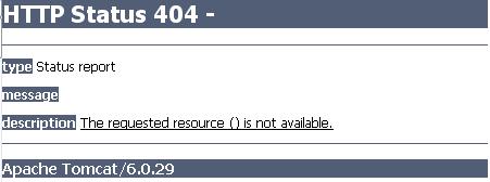

indeed, the entire contents of the error message that occurs when i hit the Search button are dumped into the catalina.out file. I'll post a sample of it below. I'm also seeing some memory leak statements, but they would make a lot more sense if all Subsonics failed, including 4.1. But 4.1 works perfectly.
The other thing I'm seeing, and I'm starting to wonder if perhaps this is an issue, is the fact that simply renaming the "Subsonic" folder to "Subsonic_4.1" prior to installing the new 4.4 version.. seems to cause conflicts within the catalina.out file. Meaning.... I have full SS folder trees in Tomcat6's webapps dir, called "subsonic_402b", "subsonic_41", "subsonic_43"... then I deploy the Subsonic 4.4 WAR file and it becomes "subsonic". I'm wondering if leaving all those old Subsonic versions in webapps (despite being renamed) is causing conflicts.

And lastly, the error about the Search engine:
[2011-04-07 13:54:38,441] ERROR org.springframework.web.servlet.tags.form.HiddenInputTag - Invalid property 'offset' of bean class [net.sourceforge.subsonic.command.SearchCommand]: Bea
n property 'offset' is not readable or has an invalid getter method: Does the return type of the getter match the parameter type of the setter?
org.springframework.beans.NotReadablePropertyException: Invalid property 'offset' of bean class [net.sourceforge.subsonic.command.SearchCommand]: Bean property 'offset' is not readable

That said... I do believe we've got the problem with the CoverArt 404 Not Found. I hovered the mouse over that link and it showed ".../Subsonic/coverArtSettings.view?"
Well, I looked in the $SUBSONIC/WEB-INF/jsp folder and there is no such file. But I looked back at the 4.1 SS and indeed, there is a "coverArtSettings,jsp" file!
So, Sindre, if you're reading this thread -- looks like the packaged 4.4 WAR file is missing that coverArtSettings.jsp file. I tossed the one from 4.1 into the 4.4 folder, and sure enough that resolved the 404 Not Found issue.
So... one down and one to go -- CoverArt fixed, but Search still a no-go re: the "Invalid property 'offset' of bean class" error. Really appreciate this help, guys...

Correction to above. The coverArtSettings.jsp file is indeed missing from the 4.4 WAR archive, but.... moving the 4.1 file over (and ensuring proper owner/group/permissions) does NOT resolve. It still results in:
HTTP Status 404 -
type Status report
message
description The requested resource () is not available.
Apache Tomcat/6.0.29
Restarting Tomcat6 each time in full for good measure -- why it's not seeing the coverArtSettings.jsp file I copied in there, is strange.
Supra92

Postby supra92 » Sat Apr 09, 2011 3:23 am
Absolutely... here ya go:
Note, too, that hovering over the other menu choices near "Cover Art" correctly show FireFox pointing to the other .jsp files that do exist as well.
Now, clicking that Cover Art link results in this:
And that's what makes no sense. However in 4.1, that coverArtSettings.jsp file does exist --- if it was removed in 4.4, then it seems illogical that the Cover Art link up top would still point to it.
Lastly, here's the Search box failure:
As for the WAR deployment, definitely not manually deploying. The way I'm deploying is downloading the latest war zip file from SS site, unzipping it in my home directory, and then copying the .WAR file into $SUBSONIC_HOME/webapps. When I do a "service tomcat6 start", Tomcat automatically deploys that WAR file and creates the "subsonic" directory and subdirs. That's how I deployed the 4.4 version of the screenshots above.
The system reboot was purely a one-off, first time I'd done it. Generally (as with most things Linux) a simple service restart will suffice (service foo restart, for sysV flavours).

Question, however: when you hover over the "Cover Art" link in that upper menu under Settings.... what does your browser show as the destination URL, for 4.4? is it "coverArt.jsp"?
