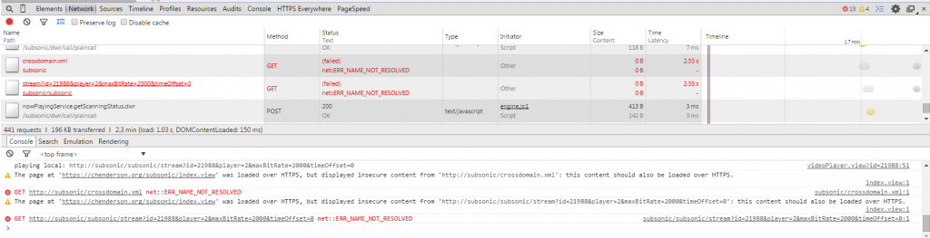

Under a reverse proxy the client will attempt to access the proxied domain rather than the proxy itself when retrieving crossdomain.xml and the video stream itself. This results in a "Video not found or access denied" error.
Example Chrome console output:
(http://i168.photobucket.com/albums/u171 ... bsonic.png)
You can see that the client is attempting to use the name of my upstream block as the domain to reference (without using the upstream block the above simply changes from http://subsonic/subsonic/foo%20bar to http://localhost:4040/subsonic/foo%20bar).
