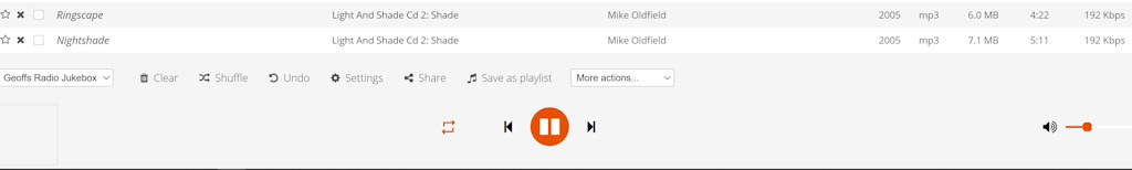

If you look at the bottom of your current playing list on the lowest line is a Share link!
Geoff G8DHE

Re: Lost ability to create a new public link
Postby malebron » Wed Jul 29, 2020 10:58 pm
Thanks @G8HDE - That's what I remember. Thanks for proving I'm not going crazy!
Trouble is, there's no share link there now! This is my problem. Where has it gone, and why?

Postby G8DHE » Thu Jul 30, 2020 9:44 am
Its at the bottom of the scroll listing itself not the bottom line of the screen that doesn't scroll, you just tick the boxes and hit Share.

Postby malebron » Thu Jul 30, 2020 6:03 pm
Thanks @G8HDE - My UI looks like this, but the Share link is missing on my screen.
(Are there instructions somewhere for how to post an image?)
This explains why it seemed so obvious to me in the past.
Can anyone tell me what determines whether the "Share" link is displayed? Something in my system must have changed (maybe an update to other software?), but I don't know where to look...
