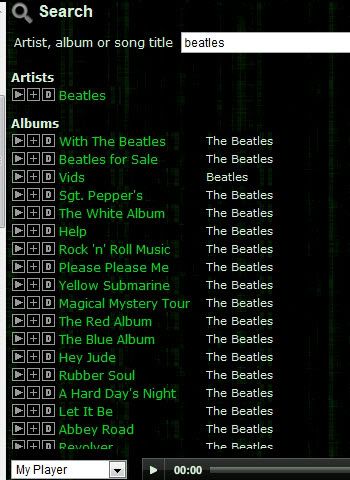

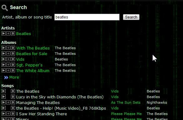

Postby BKKKPewsey » Sun Sep 18, 2011 2:01 am
This is what I get
and if I click more on the album list
My folders are organised as music/1st artist character/Artist/album/tracks
eg music/B/Beatles/Album/tracks
Notice that my folder is called "Beatles" but the ID tags are "The Beatles"
hence why they are shown without the "THE" in the artist field but that shouldn't make any difference :?

I am assuming that the left pane artist list is showing "The Beatles"
If so it is one of Subsonics little mysteries :roll:
