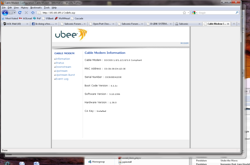

Postby Falcon5783 » Fri Jul 15, 2011 5:46 am
Sonuva... 192.168.100.1 did it... that pulled up the modem info page, I just have to find the login now
Falcon5783
Posts: 30
Joined: Fri Jul 15, 2011 4:13 am
Postby Falcon5783 » Fri Jul 15, 2011 5:48 am
No management/settings to change there, it's all just status/upstream/downstream information. I may have to call in to comcast in the morning
Falcon5783
Posts: 30
Postby dcuellar » Fri Jul 15, 2011 5:50 am
post a screen of what you are getting.
dcuellar
Posts: 97
Joined: Sat Feb 05, 2011 3:23 pm
Postby Falcon5783 » Fri Jul 15, 2011 5:55 am
Falcon5783
Posts: 30
Postby dcuellar » Fri Jul 15, 2011 5:57 am
Yeah, It looks like it's not your modem causing the problem. Perhaps its the port forwarding on your DLink or the static IP on your host PC is not set up properly.

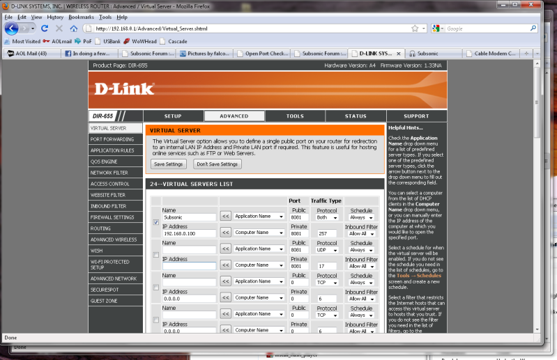

Postby Falcon5783 » Fri Jul 15, 2011 5:59 am

Postby dcuellar » Fri Jul 15, 2011 6:00 am
One more thing. Try logging in with admin as the username, and "cableroot" as the pass on the Ubee. See if there are any options listed there.
Also, If you wanna post screens of your DLink port forwarding and host PC static IP set up I will gladly take a look at them and see if there is anything wrong with them.

Postby Falcon5783 » Fri Jul 15, 2011 6:01 am
I've read somewhere, I don't recall where, that the Dlink has to have two IP forwards setup. One from the modem to the router, and then from the router to the PC. I don't know that this is accurate, let alone how I would do that. My understanding is that what Virtual Server/Port forwarding does; when a request hits the router, the router checks the port # and forwards it to the corresponding IP address per the rules set

Postby dcuellar » Fri Jul 15, 2011 6:08 am
I don't understand why you have "257" under the port number.
Here is a link showing how to forward ports for subsonic on DLink. That might help. It doesn't say anything about setting up two IP forwards.

Postby dcuellar » Fri Jul 15, 2011 6:09 am
Ah, I see. (As you've mentioned before) You are using the virtual server. Try the port forwarding option.
I don't understand why you are using virtual server.

Postby dcuellar » Fri Jul 15, 2011 6:14 am
Falcon5783 wrote:I've read somewhere, I don't recall where, that the Dlink has to have two IP forwards setup. One from the modem to the router, and then from the router to the PC.
If your modem had a NAT, you would do that. We have determined though that your modem does not.

Postby Falcon5783 » Fri Jul 15, 2011 6:17 am
I've tried both port forwarding and virtual server with the same results, "Reason: Connection timed out." Virtual server is for specific port #s, Port forwarding you can put in multiple/ranges of ports.
