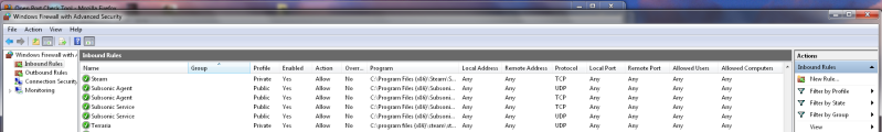

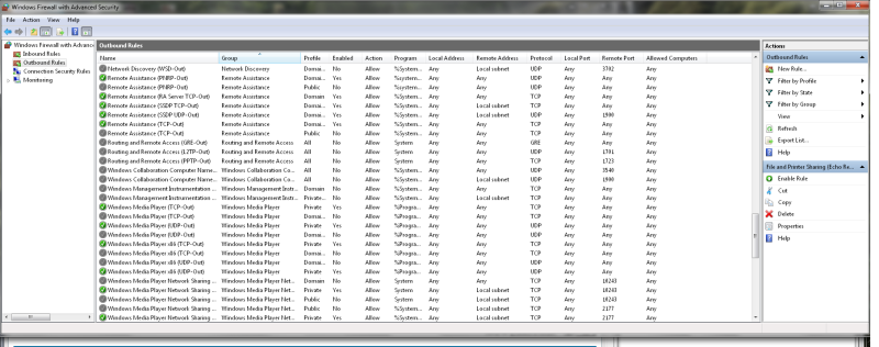

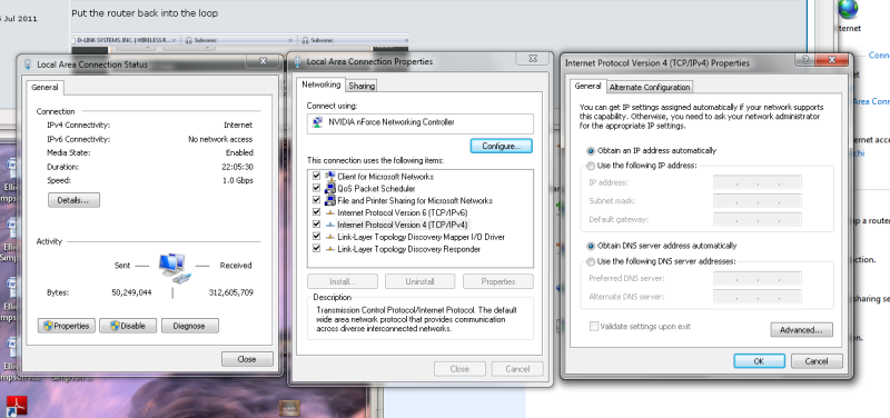

Postby dcuellar » Sat Jul 16, 2011 1:23 am
Falcon5783 wrote:Image
I'm assuming the outbound rules were done as well, right?
Also, please post a screen with the window showing your assignment of a static IP.
Control Panel > Network and Internet > Network and Sharing Center > Local Area Connection > Properties > Internet Protocol 4 > Properties (This is the screen I want to see)

Postby Falcon5783 » Sat Jul 16, 2011 1:28 am
Put the router back into the loop

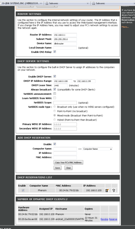

Postby dcuellar » Sat Jul 16, 2011 1:32 am
Your router screen shows that your DHCP range is from 192.168.0.100 to 192.168.0.199.
What is the static IP assigned to your computer? It has to be 192.168.0.200 or greater.

Postby Falcon5783 » Sat Jul 16, 2011 1:36 am
I have an exception in the router to always assign 192.168.0.100 to this PC based on its MAC address. I know it's not static IP addressing, but I thought that was the same effect?
I checked the outbound rules and can't seem to find anything there for subsonic...
Falcon5783
Posts: 30
Joined: Fri Jul 15, 2011 4:13 am
Postby dcuellar » Sat Jul 16, 2011 1:58 am
Ok. Don't worry about the outbound rules for now. Let's set your static IP up the proper way. Do this. That exception in the router to always assign an address....delete it.
We are going to do this the other method...plus, you can't assign it an address within the range, it has to be an address outside of the range. So let's go ahead and just use 192.168.0.200 assuming you will leave your DHCP range intact.
Then you need to follow these steps. http://portforward.com/networking/static-win7.htm
dcuellar
Posts: 97
Joined: Sat Feb 05, 2011 3:23 pm
Postby Falcon5783 » Sat Jul 16, 2011 2:06 am
Took out the exception, turned off DHCP on my local machine and assigned it 192.168.0.200
